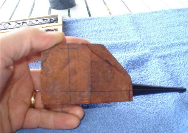

Some critical planning:

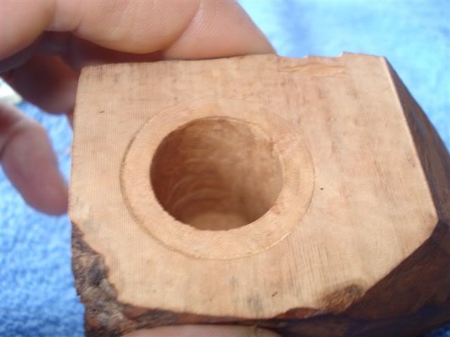

A little drilling:

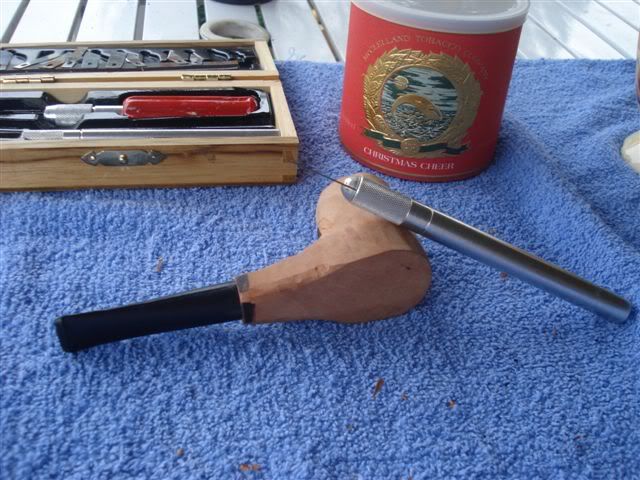

And lots of carving, filing, sanding and shaping:

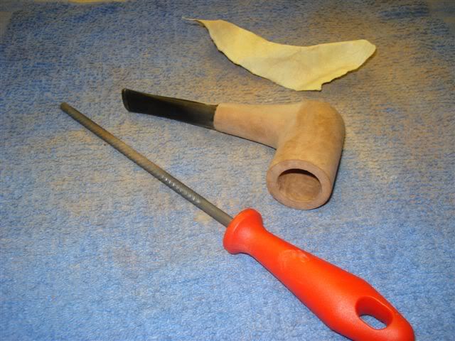

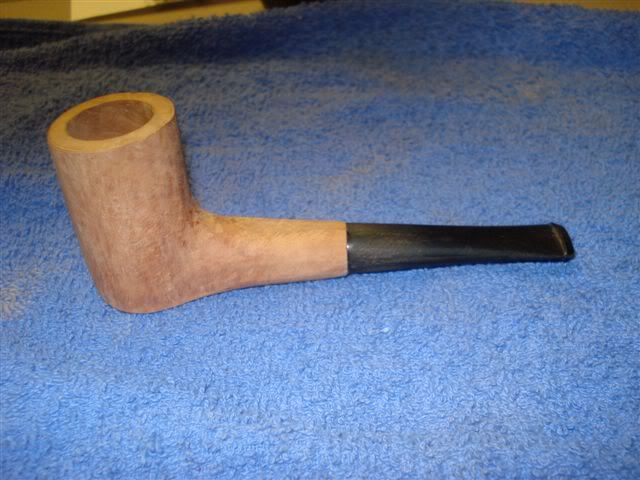

And voila...it's in it's final shape:
A little drilling:
